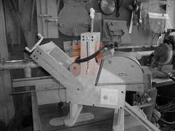

Well...I promised I'd publish my attempt at bending so here goes.
Some particulars:
-SJ style
-WFB Thickness = .090-.095
-Bender
...Two 200W and one 150W bulbs.
...Interior lined with aluminum flashing for maximum heat reflection.
...The bottom SS slat coated black for maximum heat absorption.
...Also employed a silicone heat blanket on the top side of the wood.
...Measured temp using a StewMac surface pyrometer at the top of the lower bout.
-Wood Prep
...Cut and contoured the side to dimensions listed on Michael P's OLF-SJ drawing.
...Sprayed the wood liberally with "Super Soft" veneer softener and let sit for 30 minutes.
...Wrapped the side in craft paper and sprayed distilled water until it was soaking wet.
...Marked waist position.
-Heating Process
...Followed John Hall's posted suggestions:
...Preheated to 325*F
...Sandwiched bottom slat/wood/heating blanket/top slat.
...Load the sandwich into the bender and allow the temp to reach 325*F
...Lower the waist caul just enough to hold everything in place
...Slowly set the lower bout
...Slowly set the upper bout
...Slowly close the waist caul over a period of 1 minute
...Keep the 325*F heat on for 3 minutes
...Turn off heat and allow to cool to RT
...Turn on heat to 300*F for 5 minutes
...Turn off heat and leave in the press for 3 hours minimum.
The process went well with no cracking or splitting sounds...only steam hissing. When it came time to remove it from the press it came out as dry as a bone. Unwrapping the craft paper revealed a perfect bend...no cracks, chips or distortions...only some slight grain raising. The bending was a success.
There is one problem which still has me steaming... During the process of setting the upper and lower bouts and before bottoming the waist caul, the waist location on the side shifted toward the upper bout. This resulted in having more wood at the neck center line and no wood at the tail center line.
So I walked away from the whole mess and played golf today. In order to use the side, I'll need to get it flat again and re-bend. I plan to flatten by heating it up with the silicone blanket and keeping it weighted after it hopefully relaxes.
Any suggestions would be appreciated.
Steve, I'm confident in the process as I described but a sample of one does not necessarily make a standard procedure. I'll post more as I do the re-bend as well as the second side.
Note to self...make sure the waist location doesn't shift. I may set the waist caul first next time around the way I've done it in the past. That way, the waist location won't shift when I set the lower and upper bouts.

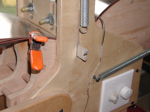

JJ, do you have a bar in your waist area? This is an addition that Charles came up with shortly before I studied with him and it makes all the difference.
I'm not sure if the LMI plans/kits include this bar. If you want more info, let me know, I'll post more/better pics. Paul
PostPosted: Mon Nov 14, 2005 1:33 am
Paul I would sure like to see more pic's of that bar.
PostPosted: Mon Nov 14, 2005 2:17 am
OK, I'll attempt to explain this. I'll assume that none of the plans use this design and that none of you have ever heard of it (I know I'm wrong, but that's how I'll attempt to go about explaining it. )
The first thing you'll need is a notch in all of you forms. Make it at the very apex of the waist curve and 1" deep by 1/4" wide.
This notch will accept the bar as it's lowered. This will allow the bar to be completely burried into the form thus allowing the caul to seat all the way into the curve. If you make the notches in the very apex of the curve and make a mark on what will be the very apex of the wood, this also serves as a registration system.
The bar itself is 1/4" by 1" piece of aluminum with some sort of notch in the ends to accept a spring. The spring is attached to the top of the tower and when hooked to the bar, applies counter pressure to the waist bend.
As you can see in the last photo, the spring is attached to the bar and the slats/blankets/ wood pack is pulled tight against the caul at the waist (it looks, in the photo, like there is a large gap but the pack is tight against the very center section of the caul).
This does two things: 1) allows you to position the pack with the waist line right where you want it, apply the spring tension and not worry about it slipping and giving you a bad bend as JJ just experienced. and 2) applies counter pressure at the apex of the bend, helping to prevent cracking at the waist.
I'm trying to work on a way to incorporate this into the cutaway tower but there are so many non-constant variables that it is very difficult to make it work.
Anything I missed?
